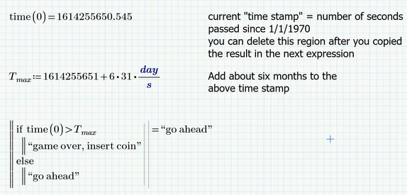

Here is an example of my last suggestion

In Prime you can use the time() function which gives you the number of seconds since 1.1.1970. You can now write a routine to get the current date using the number returned by time(0).

For your purpose you won't need the current date, though. Simply add the number of seconds in six months to the result given by time(0) now. If the result of time(0) exceeds this number, its six months later. You may be generous and use 31 days for a month 😉
