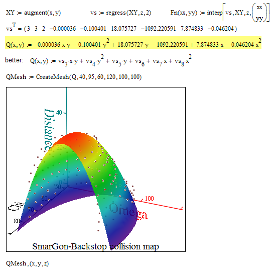

I tried to create a surface with CreateMesh (using regress and interp with all the points, not the fitted curves) but it seems that I do not have access to the equation which links the points. Is it possible to get an equation of the surface?

So your question is, how to get a look at the equations itself, right?
If you are happy with the polynomial approximation of second order you did in your file with regress, its easy to get the equation because the 6 coefficients are part of the vector vs you create using "regress".
If you look at the help for regress you will find a link to a quicksheet at the end of the text. This quicksheet tells you, how to extract the correct coefficients.
In your case (2 variables and order 2) you may do like this:

For problems were a polynomial fit is acceptable, regress works to create a surface fit.

Is there a way to use an exponential fit instead of a polynomial one in 3D?

Not out of the box as we have it for 2D, but you can always set up your desired function, define the residuals and minize them using the "minerr"  function.
Which 3D-function du you have in mind when you say "exponential fit" in 3D?
