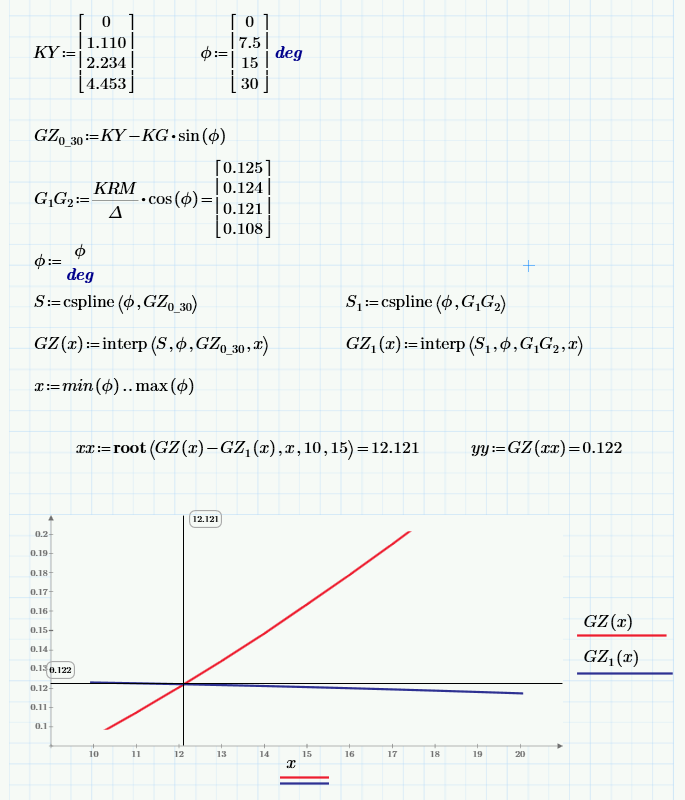

I'm working on a problem where I've plotted two curves and would like to calculate the exact point where the two curves cross eachother.
Does anyone know how to do this in Matchad Prime? Please see attached worksheet.
hsvarstad1-VisitorAuthor
January 23, 2016
Just to clarify: I'm want to find the value for phi where the curves cross.

Thank you very much
