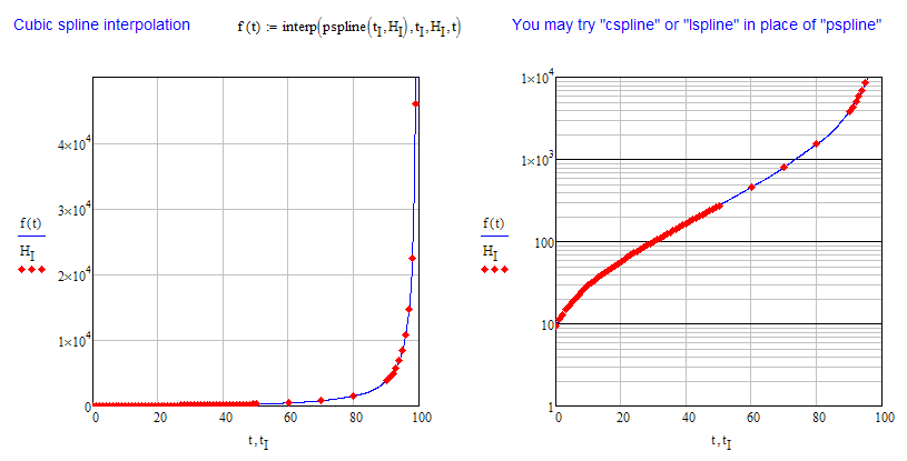

Or you could use spline interpolation.

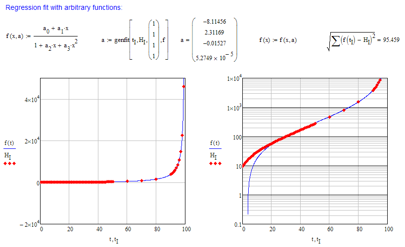

Do you need an analytic function or would a piecewise interpolation would do the job as well? Or are you in need for a regression function (of which type?)?

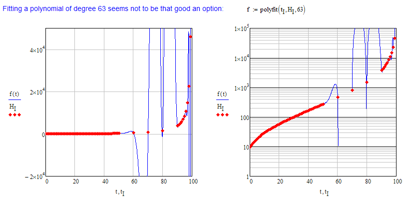

maybe a Lagrange interpolating polynomials that fits this data
Hmm, this would be a polynomial of order 63 and sure suffers from some bad oscillations. Wouldn't recommend using it:
If interpolation is all you are asking for, you basically have the choice between simple linear interpolation (see attached file) or cubic splines:
If you are in need for an analytic function you would resort to an approximation by regression. Playing around and trying various function types, I, too, found, that a rational polynomial gives the best fit so far. But Richards approach of fitting the log data with a rational of higher degrees polynomials gives you an even better fit.
