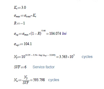

What is the best way to handle units in a curve fitting equation situation.
On line 4 if I leave the ksi in then line 6 does not work, I had to create a unitless line 5 to get line 6 to work. Also I had to text in the word "cycles"  because MC does not take cycles unit in lines 6 & 8.

1) To be able to calculate "sigma -23" obviously both must be of same dimension. Itz can't work if sigma has unit ksi and 23 is unitless
2) The arguments of functions like exp, log, sin, etc. must be unitless. Thats not a limitation of Mathcad, though 😉
3) If this is an old empiric formula, you may assign unit ksi to sigma and then use log(sigma/ksi-23) to make it work. No need to create a unitless variable manually.
4) Concerning cycles you may define your own "unit" (its not a unit anyway) for this. Assign cycles:=1 and label the word cycles as "unit".

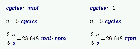

cycles: = 1
Pi + cycles=4.142 ???
Better use cycles: = mole
January 24, 2018
Garbage in - garbage out 😉
Is it really better?
