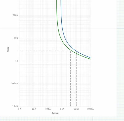

Something like this:
Keep in mind that Primes plotting capabilities are mediocre and very limited. If you need grid lines you would have to create them yourself. Luc and also myself had posted routines to do so a couple of time here. Lucs varaint has the  advantage of working OK in Prime Express, too.
You could also use the third party chart module which they additionally (poorly) integrated in Prime 6. It does provide grid lines, labels, etc, but it does not support units, is very slow with an awkward user interface and is kind of unusable when used in conjunction with a 4K display as it does not scale properly.
P6 file attached

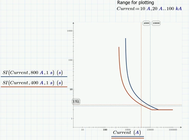

23-Emerald I
March 11, 2021
What you can do in Express if you work at it:
