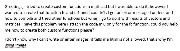

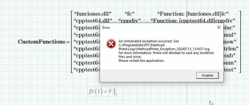

Greetings, I tried to create custom functions in mathcad and it asks to do so, however when I tried to create the function fc and fc1 I found an error message
Translated the text from Spanish to English using google translate
Body - Saludos intente crar funciones personalizadas en mathcad y pude hacerlo, sin embargo cuando intente crear la funcion fc y fc1 encontre un mensaje de error

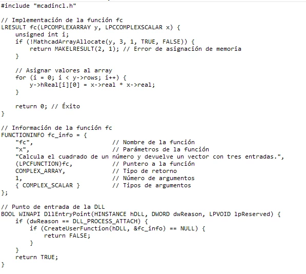

There's just one problem here, the indices on the return vector/matrix are switched.  Per the Mathcad Prime documentation for LRESULT:
The arrays and scalars that you can pass in and out of a DLL file are always complex, and arrays are always two dimensional. You can access the real and complex parts of any scalar input value by using the ParamName->real and ParamName->imag members. Similarly, you can access the real and complex parts of any input array by using the Array->hReal and Array->hImag members. Arrays are indexed by column, then row, as opposed to the order of indices inside PTC Mathcad (by row, then column). All arrays are assumed to have two dimensions. To reference a vector, you set the first array index (column) to 0, for example:
• ArrayName->hReal[0][row], or
• ArrayName->hImag[0][row]
Your code is over-running the dimensions of the y matrix in the column direction.  Just swap your indexes to:
y->hReal[0][i] = x->real * x->real;
I compiled your code and it works with this fix.
