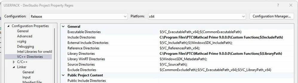

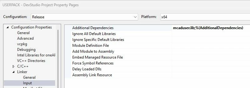

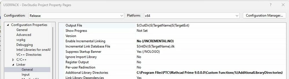

Thank you for the information provided. Followed the instructions:  Set the lib file and current Prime 9 directories.

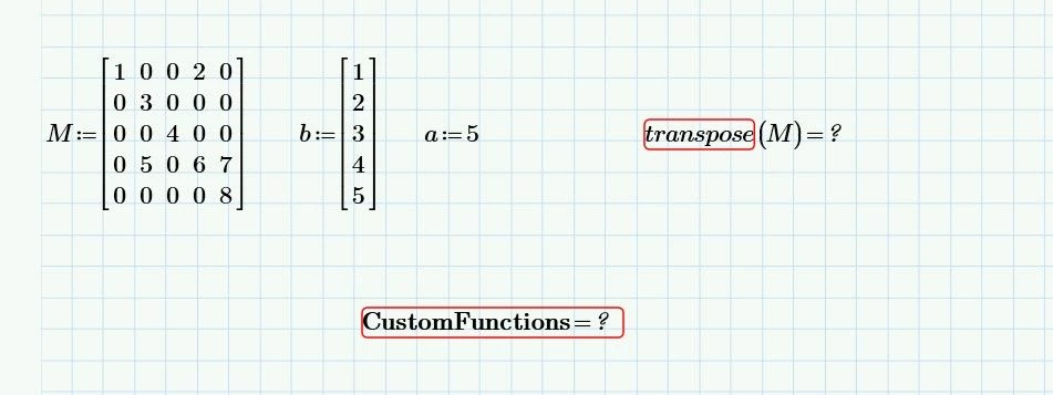

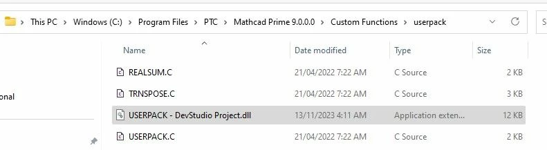

Compiles successfully and have tried the name as compiled and just userpack.dll
Nothing:
Can someone supply me a working dll for say multiply.dll to see if my install of Prime 9.0.0 is suspect.

Did you start Prime  - after -  you put the .DLL in the right folder?
