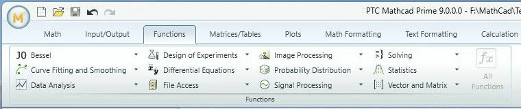

Hi have successfully compiled the multiply(a,M) example custom function but have a few questions.
Q1> Do you compile for x86 or x64 seeing as PTC Prime is 64 bit?

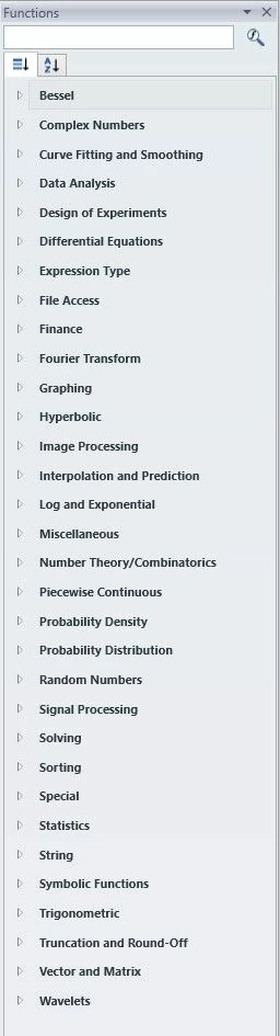

Q2> Where do you find the custom functions as neither the Prime menu or the search for all functions has a section for custom functions?  Mathcad 15 search had a specific spot.
Cheers
Terry

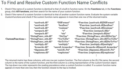

Q2: Ever tried the Prime System variable CustomFunctions?
