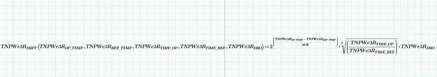

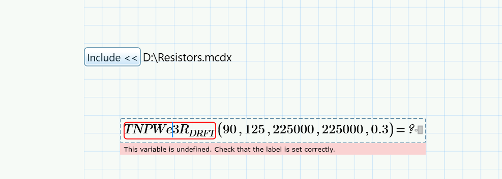

Hi all I have a sheet that I declare my custom functions like a drift calculation for resistors lets call this resistor_calcs, then if I include this sheet in a new worksheet using the include sheet function and try to use the functions in resistor_calcs I get a undefined variable error.
in resistors.mcdx I have
Now in M15 this works fine, so I wanted to ask does prime support user defined functions which are imported using the include sheet directive.
I have tried something really basic also like declaring a function x(b,c):=b+c  and then using x(1,2)=  in the remote worksheet, still this does not work.
I' running Prime 4.0.

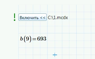

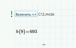

Please check attached example. Does it work normally for you?
23-Emerald V

Your function (in the subsheet) contains a power with a divisor (denominator) that has a unit.
In your calling sheet, you call the function, but without properly assigning units.
Correct that, and see if it works.
