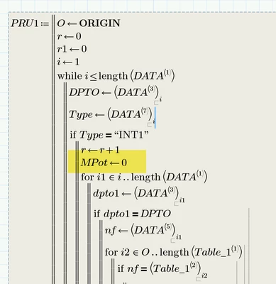

I am trying to extract values from an array named DATA and look them up in another called Table_1, and then do operations.
By manually entering the row and variables of the DATA array, I get what was expected, but when I want to do it automatically, and have the data array be extracted and compared row by row, I don't get the expected results.
I attach the spreadsheet with the exercise.
I hope you can help me.
Werner_EAnswer
You forgot to initialize "MPot" to zero, so the values of the previous calculation remained in that variable.

Werner_E25-Diamond IAnswer
