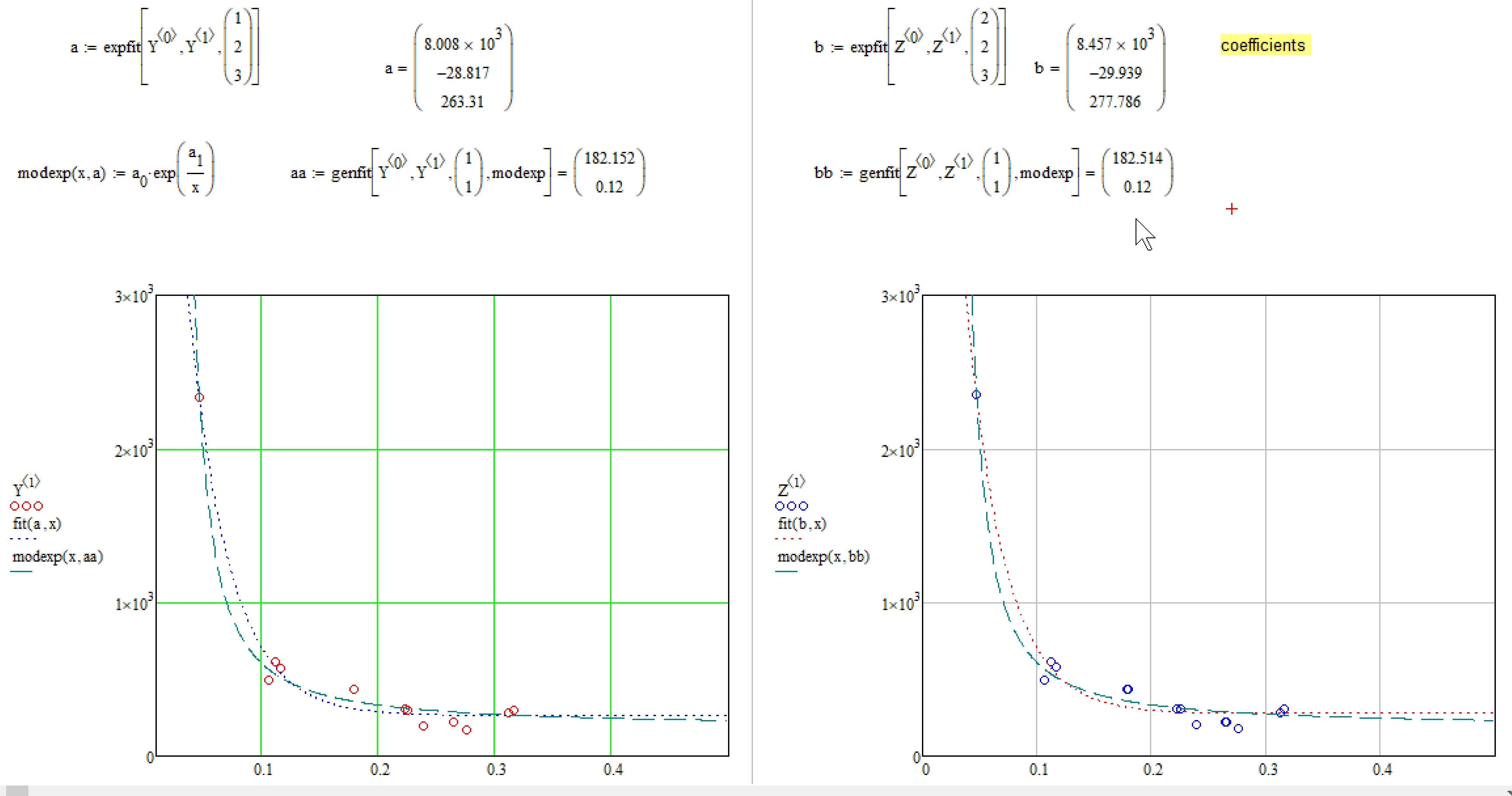

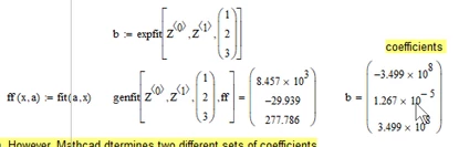

I'm currently doing data fits in a bulk; i.e. several hundred sets. Therefore, I'd like to automate this. Some data sets seemed peculiar and I noticed an odd behaviour when it comes to exponential fitting; see attached file.
In two different data sets, which are very similar, Mathcad's expfit function determines vastly different coefficients. Does any body has a remedy for this or can explain it?

I think the conclusion so far is that you are better off using genfit or a solve block as opposed to expfit or you may fiddle around with the guesses.
I don't know if this would be an option but it looks to me that a modified exponential f(x)=a*exp(b/x) might make an equal good if not even a better fit and is only dependent on two parameters (BTW, as you can see in the pic, even changing the guess 1 to 2 makes expfit work OK):

I have no explanation (other than we are dealing with a numerical algorithm trying to fins a local(!!) minimum and so depends on the guess values) so but of course you can change the behaviour by changing the guess vector. Replace the 1 there for a 10(even 2 dows the job) and your second example gives you the result you expect.
Exchange the 1 for 0.1 in the the first example and it will give you the same undesired result.
I understand thats its quite demanding how to generate appropriate guesses in a bulk processing.
You may provide a few different guesses and calculate the Error (least squares) for the fit you get with each of them and then keep the best.
I also noticed that genfit seems to do a better job (at least with your second example).
Maybe a solve block with minerr does even better. At least you get the error immediately by evaluating the system variable ERR after the solve block.

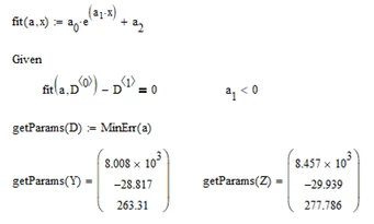

If you build a solve block, you can force the exponent to be negative.  may be enough. . .

You have put the <0 in the index but the solve block gives the desired result even without this constraint (as does genfit). Looks like expfit is in some way too sensitive wrt guesses.

Just to justify my coffee consumption, I've modified the attached file from the previous blunder.
One thing to note:  change the TOL definition off and on, watch the results change!
April 25, 2018
Interesting observation - so the solve block is affected by TOL but expfit seems to be not.
I don't think that you should abandon you solve block - it might be that the constraint a[1 < 0 can be necessary for other data sets.
I am not sure if it better to use minerr (for which I have a tendency to) or minerr as you did. The results are marginally different and minerr seems not to be dependent on TOL.
For the two datasets given the constraint a[1<0 would not be necessary and if I change that to a[1 > 0 is has no effect at all ? 😞
