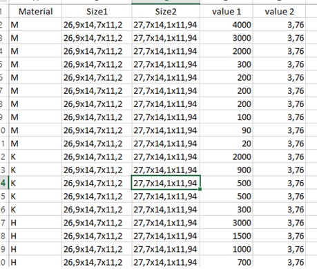

I am making a calculation worksheet with a number of back data and I want to know how to syncronize data, like. (refer to the attached also)
I have 4 materials for moment having information of size 1&2, parameter 1&2.
Some information is duplicated, some is not.
Under this situation, I want to program like..
when I select material 1 in the 1st list box (or ribbon which is more favorable), the second list box (or so) shows only the applicable information.
the third, forth and fifth.. accordingly.
Any advice on this?

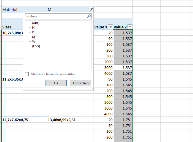

BTW, I am not still pretty sure how to use (or start) list box for those data - maybe as you said, it's not easy to explain with example sheet.
what I want to do is like PIVOT in excel - Only possible to show (or be able to select) applicable data according to the condition.
1. If you choose material M,
2. Only following size(sizes) is shown
3. Then, surely only following value is shown. (Size A would have values 130 and 500, while Size B would have ones 130 and 400)
