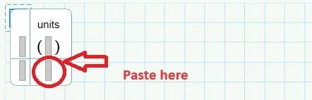

Since the thread on large combo boxes have realized you can cut and paste large data from a Prime matrix into the combo box just not into the first column of the combo box.  A large matrix can be read into Prime by READEXCEL() copied into the combo box. Matrix then deleted leaving the combo box
What is returned when you select the entry in combo box is a column vector containing that row of the matrix.

And copy and paste is implemented in Prime in such a silly way that only the visible part of a matrix is copied.
So it seems it would be necessary to enlarge the matrix to be displayed to its full size in Prime before copy and paste would work.
Thats quite uncomfortable and maybe modifying the xml as you described in an earlier thread is even easier?
Or am I missing something concerning copy&paste a large matrix?

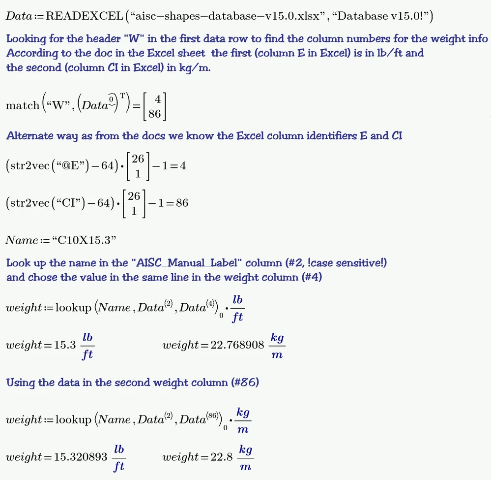

Here is the implementation of the most basic way (using READEXCEL() and lookup() as already described.
Its sure not very comfortable as you have to take great care when typing in the Name to use the proper case (C10x15.3 would throw an error because of the lower case "x") and avoid typos.

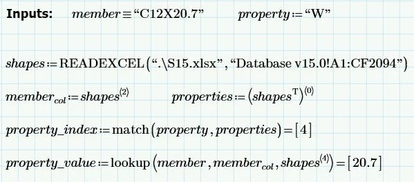

However, I would like to make it a bit more automated. I'm trying to do something like the following: Create a function with two inputs (member and property) and returning property_value. I'm getting stuck with the last line of code. When I try to call the lookup function with the property_index variable instead of manually entering "4", it gives me "it's not an integer" error. I can't figure out how to change the property_index variable to an integer. Any ideas?

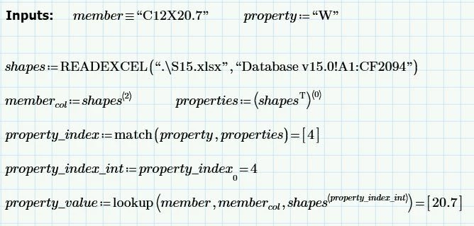

I figured it out: For anyone else who's interested. Thank you everyone who replied.
