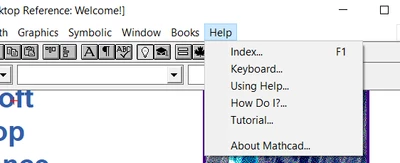

Run your Mathcad 5. Then under the "Help" menu choose "Developer's reference". In there, read the information on "Accessing Mathcad from within another application".
September 1, 2022
I dont have this line( And also I have Error opening Help, so I open *.hlp files in special website, but it doesn't contain info about DDE
