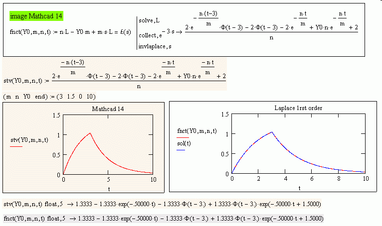

In separate sheets for easier qs style and especially for "clear var" that 14 users have reported being a problem. Try these three sheets and report to Mona if working or not. That will help the PTC team about the InvLaplace reported incorrect as per the books .
Interesting to see if it works in 14.
