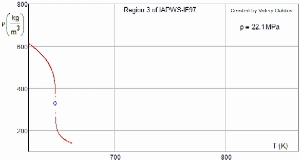

I have created I think most difficult function of IAPWS-IF97 formulation - the function wspV3PT(p, T) - specific volume (of density) of water/steam near the critical point (region 3) - see the description this function and the link on my on line calculation here
http://www.iapws.org/relguide/IF97-Rev.html
Mathcad animation has a lot helped me to find bugs my wspV3PT function!
See one animation above!

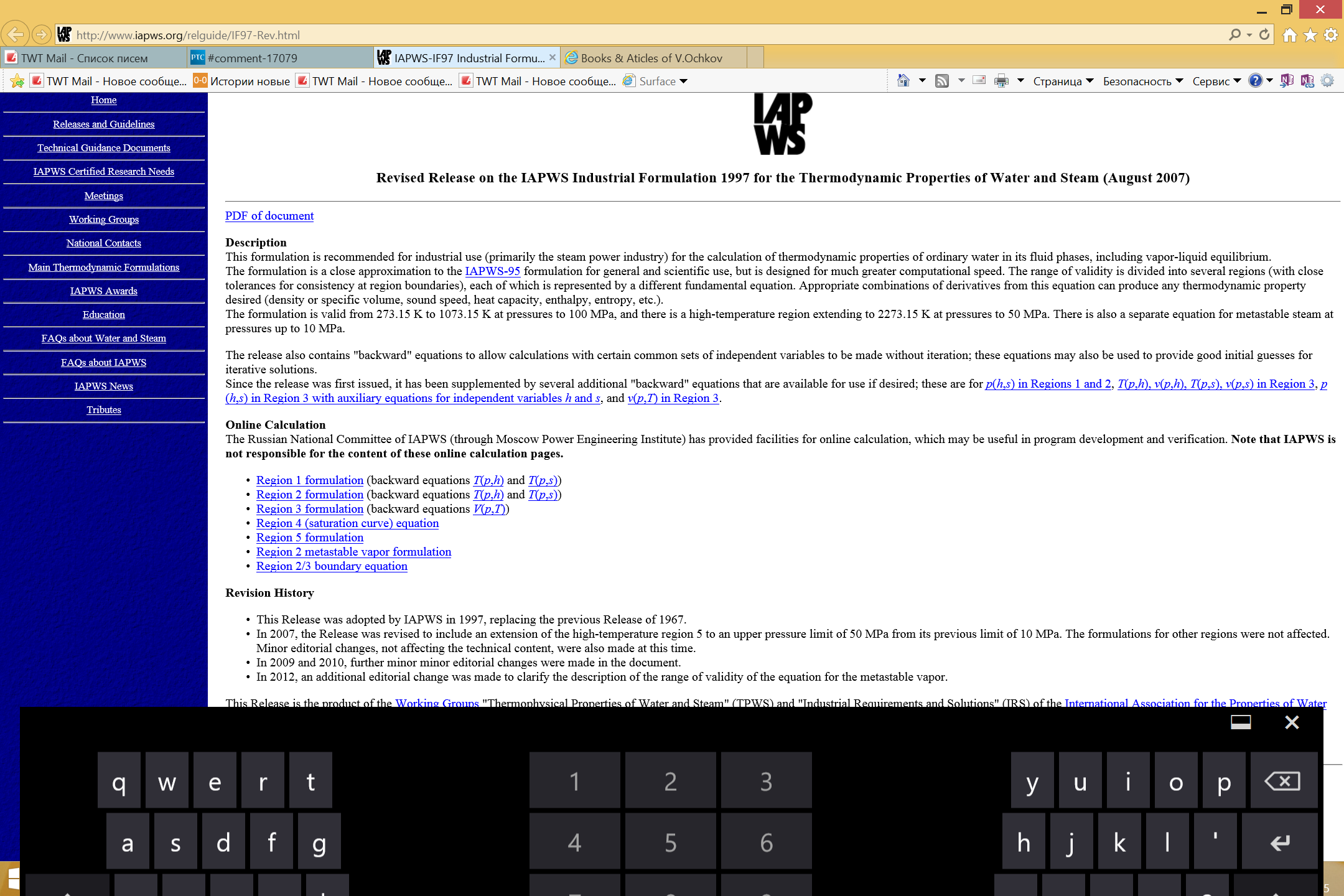

Hi..
Above given link is not working.
Prashant Pandarkar
Sorry, by me all is ok!
Read please the English article about this problem - http://twt.mpei.ac.ru/ochkov/IAPWS-TE-eng.pdf
