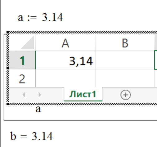

I may be missing the point, but I use a German Windows, too, and the the setting in Windows of course is using the comma as decimal separator.
I experience no problems using READEXCEL and WRITEEXCEL. Numbers with commas are correctly read in in Mathcad and use the decimal point there. When exporting floating point numbers from Mathcad to Excel I get correctly formatted numbers (with decimal comma) in Excel.

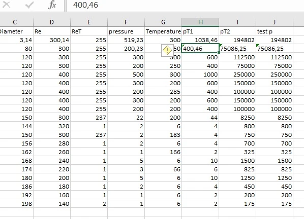

Hey guys,
routine is working but i dont get rif of the problem with the komma ;-(
Every time after opening excel it says the data is broken. And every number with komma is green. As letter saved number.
Hopefully u guys can provide me with a fix of that 🙂
The problem is that i have hundreds of different loadcases and i cannot change very each output what mathcad does in excel manually.....
regards Stefan
A and i have MAthcad 15 😞

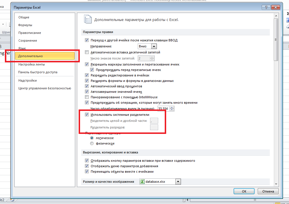

Try to change the settings in Excel (MS Excel 2010 is on screenshot below): "Excel options" --> "Additionally" --> "Options changes" --> "Use system separators".

not working 😞
i have office 2016 plus
every time the same problem grml
