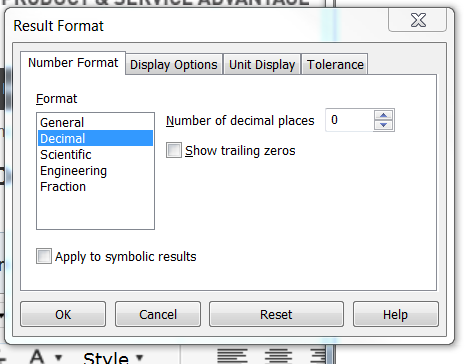

April 15, 2013
select the result to display in binary,
then the menu "format", "result"
You should get a pop-up menu like this

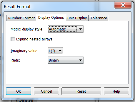

Select the "Display Options" tab
And change the radix from decimal to binary, options for octal & hexadecimal also exist.
Regards
Andy
