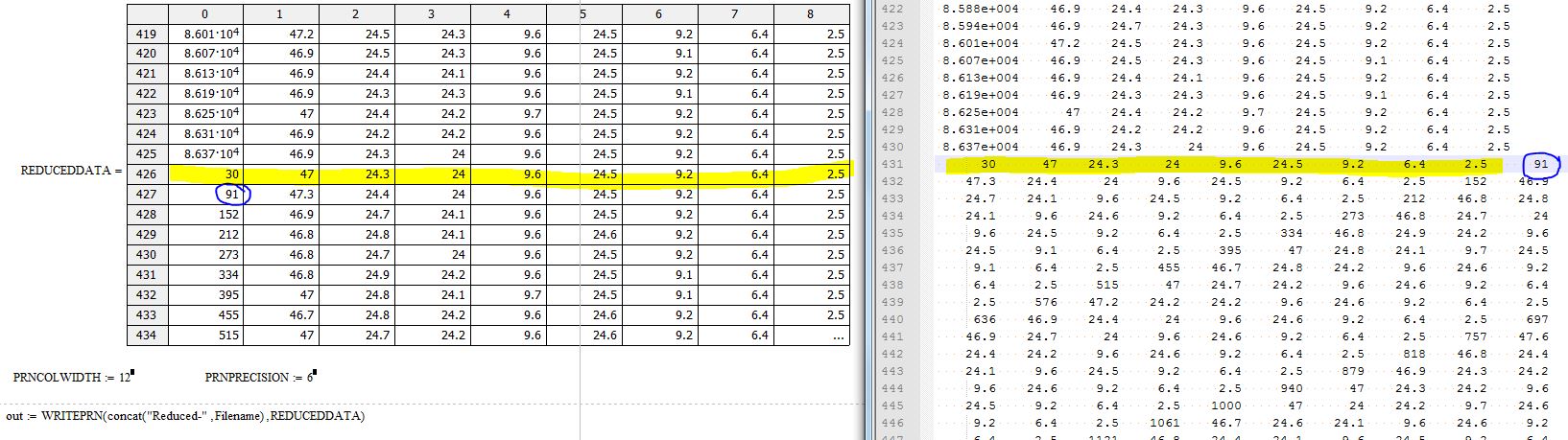

When I use WRITEPRN to write out the file, although the data seem correct in Mathcad, they appear wrong in the file, precisely they appear wrong as soon as the time goes back to 00:00:00 ... what in my actual production data can happen. I just cannot understand that!  This is certainly an error in WRITEPRN function.  I include a picture of the problem. The "yellow line" is the first wrong one: the value 91 seconds should go in the first column!
If you (or anyone) have any suggestion what I am doing wrong here, it would also be appreciated!

I understood the problem with WRITEPRN.  In my opinion, it is not intended for writing out files with a given number of columns. It is just intended for writing out a file that is readable with READPRN. I tested this rereading the file and subtracting the two matrixes.  They match.  I was confused because I wanted a file similar to my input one, with a constant number of columns.
I guess if I want that I will have to use other functions.  Still no idea which one .
