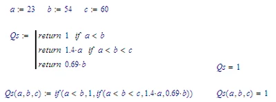

You're not declaring a varibale, but assigning it a value based upon a condition.
Two of many possible implementations:
23-Emerald I

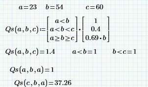

May 25, 2020
Fred,
I'm afraid this is not correct. There's an else-if between the first and second condition. In this case, with the given a, b and c, the first two conditions are both true,
but the first must prevail, becasue of the else-if.
The 'return's in my program take care of this else-if. the if() function does it also, but the vector operations don't.
Maybe this mends it:
With that:
you get
and
