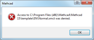

When Mathcad 15.0 opens it uses "Normal" as the default template. Is there anyway that a different template can be used as the default upon startup?

The only way (that I have found) is to make the template you want and save it as the normal template.
Save as template, file name Normal, yes replace file.

I tried saving as the Normal template but this is the error message:

Strange!
On my work computer (where I don't have admin rights) I just replaced the Normal template. So I suspect this is an issue inside your operating system. Might try saving the file wher you can with Mathcad and moving it with the operating system.
Other alternative is Normal2; it won't open on startup, but the pull-down arrow next to the new sheet icon shows all the templates in the folder so a new Normal2 is one mouse-click away!
