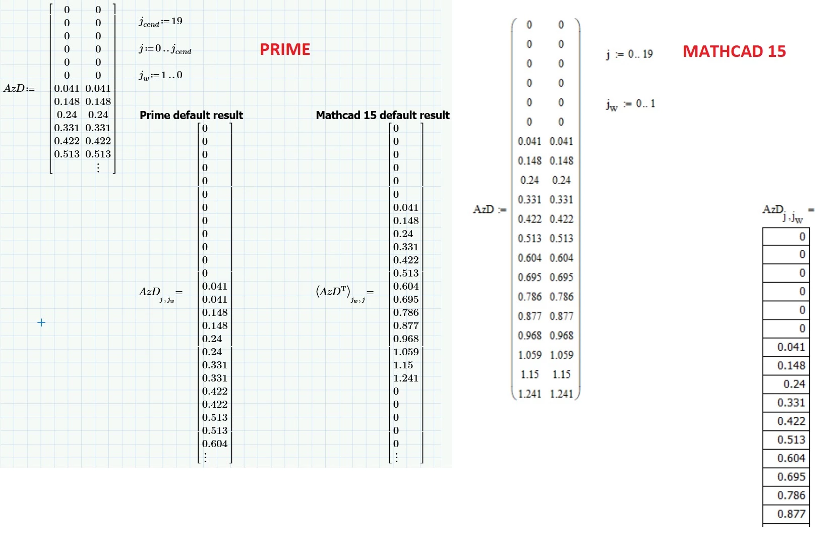

I converted a Mathcad 15 file to Prime and most of the results are different. These differences are due to the way in which Mathcad 15 and Prime append vectors vertically (see image).
The solution I found was to transpose the matrix in Prime (see AzD_(j,jw) in image). Unfortunately for this particular Mathcad 15 file, there are several matrices that have the same issue and I would have to transpose each one of them individually.
I wonder if there is a way to automatically change all the matrices in Prime that have this issue. I tried changing the range of (j,jw) without success.
P.S. I attached a Prime and Mathcad file exemplifying the issue.
