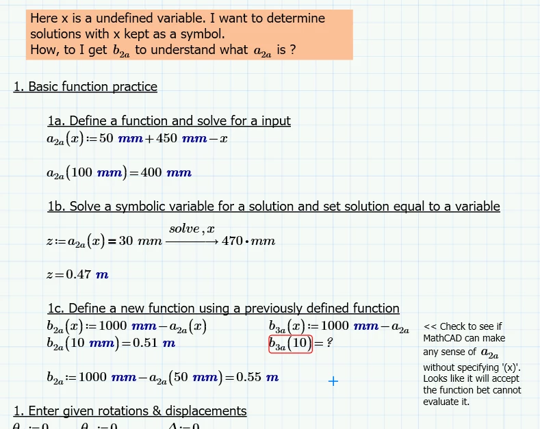

Example, I'm trying to use the slope-deflection method to solve for reactions on a beam. If I predefine almost all the variables, then no problem... if I try to do this symbolically, it doesn't work.
For examples, let's say  I do
a2(x) := 50mm + 450mm - x
Now I want to say b2 = 1000mm - a2 << a2 having the symbolic x & Mathcad does not like this.
Another example, I have defined
Mba (E, I, L1, Thetab) := 2 * E * I /L1 * (bla bla bla)
Mbc (E, I, L2, Thetab) := 2 * E * I /L2 * (bla bla bla)
Now I want to define Mba + Mbc = 0 and solve for Thethab... and I want to save this result as Thethab so I can plug it back into equations above... having trouble doing this.
However, if instead of doing Mba + Mbc = 0, I do
[2 * E * I /L1 * (bla bla bla)] + [2 * E * I /L2 * (bla bla bla)] = 0 ----> Solve Thethab, then Mathcad gives the solution solved for Thethab.... but I don't know how to plug this solution back into other equations without copy pasting the result Mathcad spit out.
Attached is a file of examples of what I am trying to accomplish. Thanks very much in advance.
Now I want to say b2 = 1000mm - a2 << a2 having the symbolic x & Mathcad does not like this..
Let's start here.  a2(x) = 50mm+450mm -x  is a FUNCTION.  a2 by itself could be a variable but you probably get a "not defined" error message.  So your second line doesn't make sense to Mathcad.
You could evaluate:  a2(10mm) =   and you would get .49m, or 490 mm.  A function takes whatever value is in the parenthesis, plugs it in wherever the x appears and returns a numeric result.  So b2(x) := 1000mm-a2(x) would work to create a second function, or b2:1000mm-a2(10mm) would return 510mm,

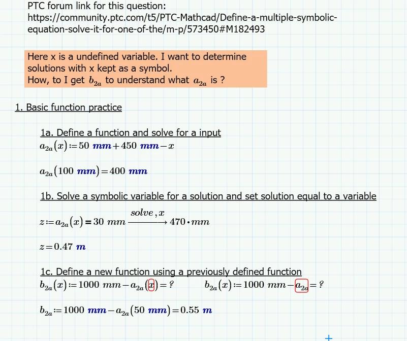

Hi Mr. Fred. Thank you so much for your response. Very helpful explanation ... it makes sense, though I still got an error on the creating a new function using a previously defined function part...
I understand if I define a function if I put parenthesis before ':=' and evaluating a2(100mm) does work - good!
I can solve for a value and set the solution equal to a variable - good!
However, I tried the b2(x) := 1000mm - a2(x) and is tells me 'x' in the parenthesis of a2 is undefined.
If I do b2(x):=1000mm - a2, it does not work either...
Attached is my update and I also added a screenshot. Thanks so much!
adesh

Sorry... I see now why I was getting the error... I can define:
b2(x) = 1000mm - a2(x), but I'm not allowed to put an '=' after that and expect Mathcad to simplify it to
1000mm - (50mm + 450mm - x). Maybe I can if I use the simplify function it might work...
I will see if I can get the rest of my worksheet working with what you taught me. It helps a lot. Thanks! adesh
