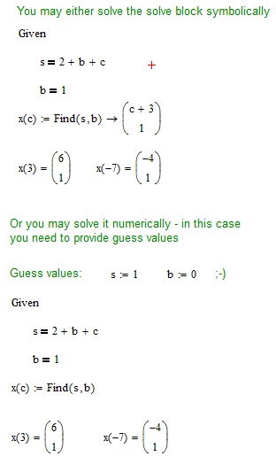

Assuming you want to use the solve block, would the following help?
23-Emerald V
Your b=1 needs no solution, it is what it is, it can be used to solve s as a function of c, or the other way around.
This is how it should work:

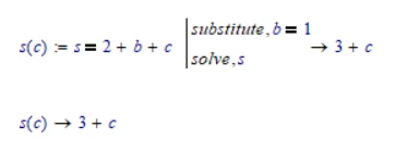

23-Emerald V

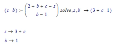

Or were you looking for this...
