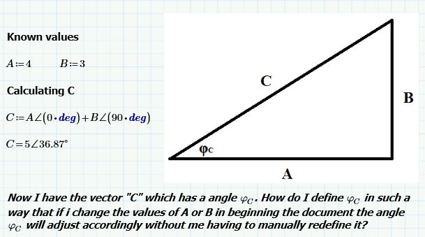

Once again a silly interface question: I have a vector in polar form. Now I could easily write down the real and the imaginary values down go on from there but I want to be able to define the angle of the vector so that I can use that angle later on. However I can not find a MathCad feature or some neat trick to get that angle defined. I have attached a picture with an example to show you what I mean.

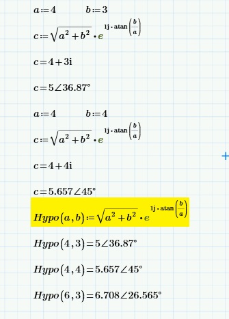

How about atan(B/A)?

I thought about that but then i would have to be able to define the real and imaginary number as B and A in order to use that calculation and i also cannot find a way to define those?

Your "Hypo" would yield wrong results for negative values of a because you use atan and not atan2.
Furthermore I wonder as of the complicated way you define this function. Guess that
Hypo(a,b):= a + b *1i
would do the very same jobin a clearer way and more convenient!

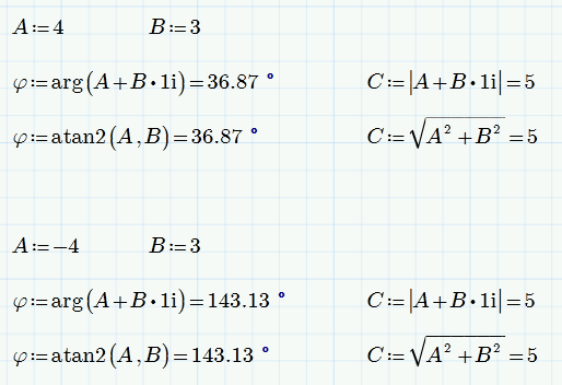

As far as I understood the question, Emil was asking for a way to "get hold" on the angle, to store it in a variable and not just to display it, Thats the reason I suggested the usage of "arg" or "atan2" as two ways to achieve this goal in my answer below.

October 4, 2016
Hope this helps:
