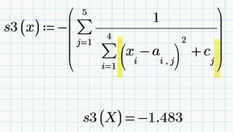

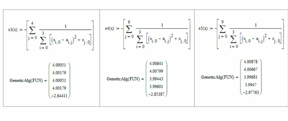

Hello everyone,
In the attached worksheet, I would like to define the Shekel family of functions using Mathcad.
I am stuck here. I can’t find the error, help me.
I appreciate it if you share your idea and advice on this worksheet.
All the best,
CarlosRomero

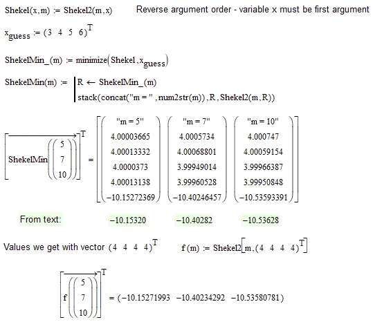

@CarlosRomero
Its noticeable that all the three minimum values given in the text are a bit smaller than the ones we can actually achieve with the function. I can't say where those values would come from, but with the table values given they can't be calculated. Also the function values at (4,4,4,4)^T always are a bit larger than the minimum values found, so Mathcad is correct at returning those values which are slightly off the (4,4,4,4)^T.
BTW, instead of using a genetic algorithm you may give "simulated annealing" a try.
Richard had provided a fine implementation here: https://community.ptc.com/t5/PTC-Mathcad/Minimizing-a-Function-using-Simulated-Annealing/m-p/445213/highlight/true#M176579
I copied his functions into the attached worksheet to give it a try

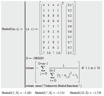

Try this
Saved in Prime 4 below.  (Sorry, don't have 15)

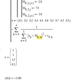

January 3, 2021

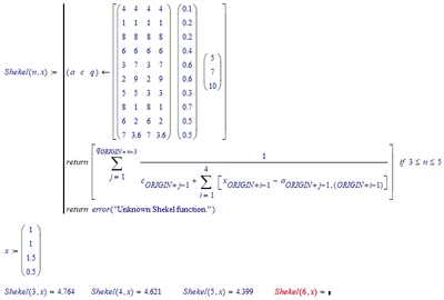

How about:

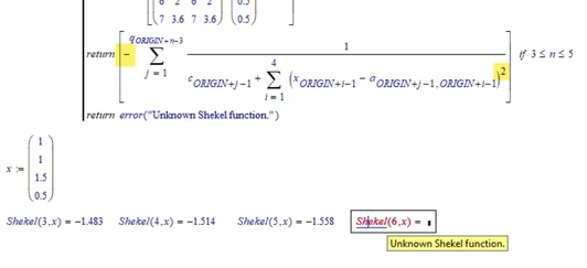

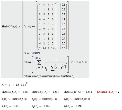

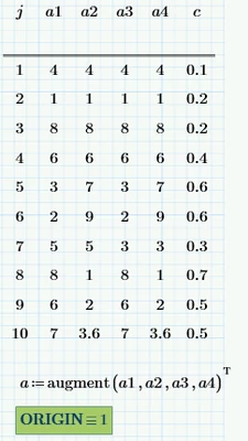

Even though your function is a bit cumbersome, it is easy to repair. You have overlooked that in the text the first index of a_i, j denotes the column and not the row. This can be easily repaired, either by transposing the matrix M or by swapping the two indices in the formula (as can be seen in the picture).
It also would be easier to define c transposed, this way you can avoid the index 0 at c.
As you have seen by the answers of Fred and Luc, its more clear and elegant to define the matrix as an array.
Luc also provided a single function for all three Shekel functions which is also ORIGIN-aware.
His result differs because he missed the leading minus sign and forgot to square the summands:
Fred used Primes table feature (not available in real Mathcad) to build the matrix. Note that he had set the system variable ORIGIN to 1 and also transposed the matrix a, so he could use the very same indices as in the text. His result is different because he mistakenly included the c_j in the sum.

Here is a slight modification of Lucs implementation
Or, to be even closer to the notation of the formula in the text

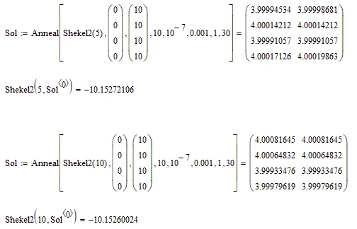

Thanks Fred, Luc and Wernner for your advice and good answers.
I applied a genetic algorithm to the shekel functions given by Fred to find the global optimum and it gives me values of the four parameters x1, x2, x3, x4 approximate to the answer indicated in the book of Zbigniew Michalewicz; that is 4, 4, 4, 4. But the value of the functions are not equal to s3min = -10.15320, s4min = -10.402820 y s5min = -10.53628; otherwise they give me values like the ones shown in the attached image.
Do you have any ideas to fix this problem?
Big thank.
