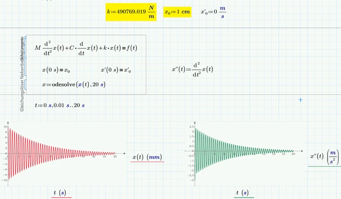

The dimension of stiffness is force per length or mass per time^2.
So you would have to change the unit for "k" to something like "N/m" or "kg/s^2" for the solve block to work.
But using the initial conditions you provide, the solution x(t) trivially would be constant zero.
I guess that you would have to change one of x.0 or x'.0 from zero to a non-zero value.
Here's an example:
BTW, you may already have noticed - the diagram components you are trying to use are not unit aware

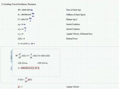

The units of
M * z''
C * z'
k * z
Must be the same. If the units of C and M are OK,  then that of k is wrong. Or the equation is wrong.
The unit of z is m, that of z' is m/s and that of z'' is m/s^2.
Luc.
could you correct for me in attachment above?
Thank u
Werner_E25-Diamond IAnswer
Here's an example:
