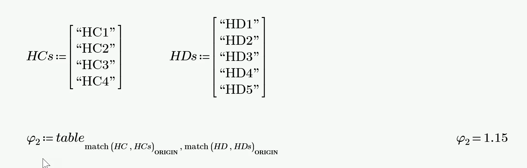

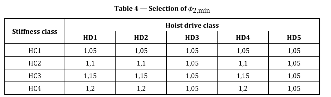

I am looking to define the variable ϕ2.min based on the table below. I have created the variables for HC and HD to define them as HC1 and HD1 etc. however I am not sure how to then pull a value for ϕ2.min based on the below selection table.
Any advice here would be great!

Define vectors for the text of the row and column headers and use “match” to get the correct matrix indices.
This work OK even if the headers don’t contain ascending numerical values. I guess I’d prefer this method.

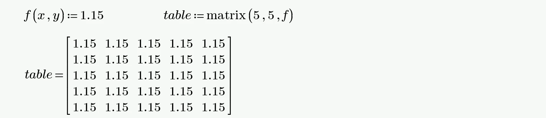

The following examples assume that ‘table’ is the 4x5 matrix with the values of your table.

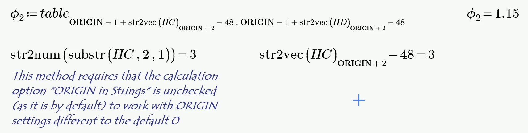

Defining HD and HC as numeric values makes it easy to extract the correct value, using HC and HD as matrix indices. As I don’t know if you changed the default value of ORIGIN (0) to something like 1, here is a version which works with any ORIGIN value:
In case HC and HD are strings, we can use the same method but we would need to extract the number and turn it into a numerical value. This can either be done by turning the string into a vector of ASCII/ANSI values, choose the third entry and subtract 48 (ASCII code for character “0”) or we could chose a substring consisting of the third character in the string and use ‘str2num’ to get its numeric value:
BTW, being lazy by nature I was cheating and used a ‘table’ with all values set to 1.15 :-)

And here is a third method you may chose.
