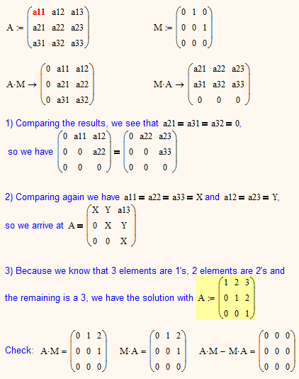

So i kinda have the same problem in these 2 problems.
First one is:
In whiich i have to find the values of A and B members.
And the second one is:
In which 3 of the members have the value of 0, 3 of 1 , 2 of 2 and 1 of 3.
In both of those i am having trouble in defining the matrices and using those matrices to find solutions.
Any help is welcome.
