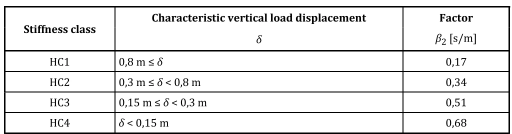

I am trying to specify the value of a variable based on the value of a second variable. The attached table shows what I am attempting to achieve is setting the value of B2 based on the value of d in-line with the data attached.
Any help will be appreciated. Thanks

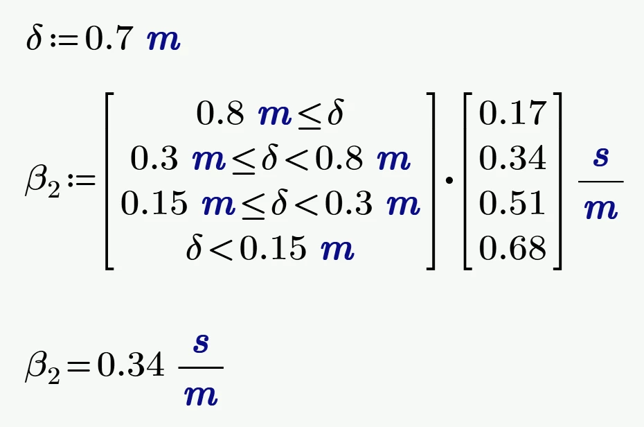

Or you may use a vector of Booleans - In Mathcad ‘true’ is 1 and ‘false’ is 0 - that’s the reason it works that way.

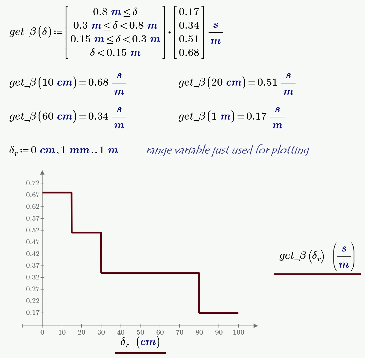

You may also turn that calculation in a function dependent on delta (write once - use many)

The vector of Booleans is an ideal way to do it thanks! I did not know about the true/false effect - that will be very useful!!
