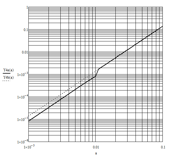

I work with WIN7, WIN XP, and WIN 2k. I use MCD-15, -11, -2001.
In all cases I find an error when calculating a definite integral. The error looks as follows: the location of a constant "a" inside the integral leads to a different solution compared with the case with the consant "a" outside the integral. This behaviour hurts the basic mathematical relationship in (1):
The result of a simple calculation approach can be studied in the following graph (solid = wrong = left side of (1)n; dotted = right = right side of (1):
In most cases it won't be possible to move constants outside the integral, hence, there should be a bug correction asap!

I am too lazy to retype whyt you had done, but have you tried changing TOL and CTOL?
I guess what you experience are just normal round off errors but I may be wrong.
For numbers stored in a computer, usually neither the commutative law applies nor the distributive. If this is the case her its not a Mathcad specific problem.

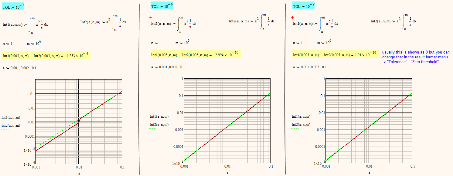

I am less lazy today, and  - voila! Seems you did not try changing the tolerance value.
You must always keep in mind, that you are doing numeric calculations using finitely many computer numbers with limited accuracy.
Here is an example which shows that summation is not commutative using this set of numbers:
Your example shows, that the distributive law is not validi in the set of computer numbers.

Many thanks for your extensive remarks. I’ve expected something like this. I know TOL’s influence.
However, I didn’t assume that Mathcad makes the precision of the integral’s result at the left side of (1) additionally dependent on the size of the constant “a”, and not only dependent on f(x), n, m, and TOL. At the right side of (1) there is no additional dependency on “a”.
I see, insofar, Mathcad treats both sides of (1) differently.
Usually, the precision of a result can be expressed in the number of digits after the decimal point. This is not the case here. A high precision of eg three digits after the decimal point is not a precision per se. It can only be achieved with the right TOL setting, which becomes in most parts of my work several magnitudes smaller (up to 10e-10) than the default TOL setting. The latter case leads to a lower precision with three digits after the decimal point.
That’s why it seems to me that the shown circumstances are not (or not enough comprehensibly) reflected in the explanations about TOL and its application.

> Why isn’t there a built-in automatic-TOL-value-setting possibility that ensures best result quality,
Thats something you sure have to ask the devlopers of MC (good luck in doing so;-)
But lower values of TOL do not always mean more accurate results (thats the nature of some of the numeric algorithms implemented) and so Mathcad can't automatically detect, which numeric result is more accurate. Furthermore you'll often run into problems when setting TOL and/or CTOL too low and may run into the "calcuation does not converge" error message.
If you need more accurate results than a numeric approximation algorithm (numeric integral) is able to provide, you'll have to resort to symbolic calculations but then Mathcad sure is not first choice and even with more specialized software you are limited - not every problem can be solved symbolically.
