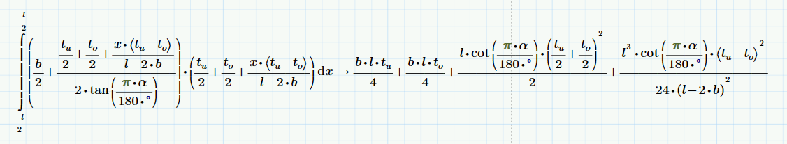

Hello again,
i'm stuck with the following definitite integral:
As you can see, the function is quadratic in x, but Mathcad Prime isn't able to evaluate the indefinite integral as ist seems. The integration variable should not appear at the right side...
What could be the reason for this behavior?
Many thanks for any Response.
Kind regards, J. Dessecker

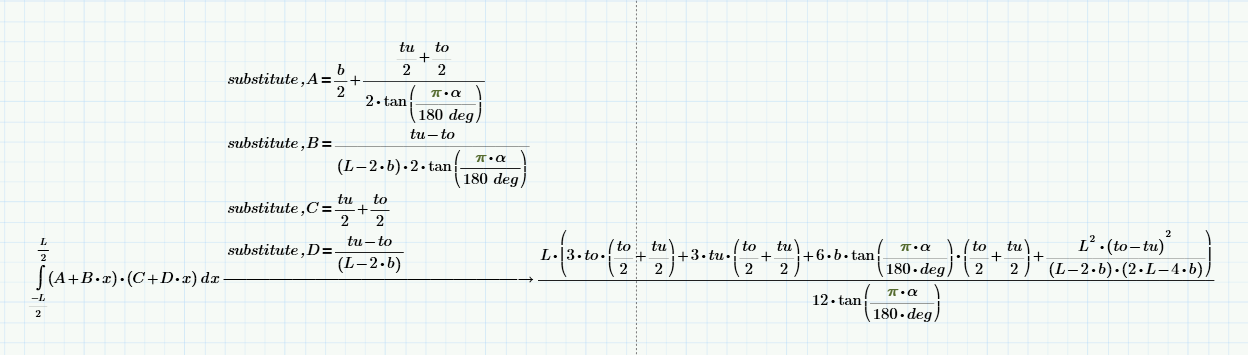

Try doing it as follows and then substitute for the constants a, b, c and d in terms of your own parameters (Note that my b is not intended to be the same as yours):
But I don't know why Mathcad objects to your original formulation!
Alan.

Apr 4, 2015 10:32 AM UTC
If you want to do it all in one go then something like this?
This was done in Prime 2, but I would expect it to work in Prime 3 as well.
Alan
Apr 4, 2015 11:18 AM UTC
Is this in a standalone worksheet, or a worksheet with a lot of other stuff that you are not showing? If it's in a standalone worksheet, please post it. If not, I assume (as before) you can't post the worksheet, but then please create a standalone worksheet with just that integral, and see if it works then.
Apr 4, 2015 11:26 AM UTC
Hello Richard,
the problem appears in the worksheet you mentioned. But i'd copied this stuff as it is in the start posting in a new worksheet, an here it is.
Apr 4, 2015 12:03 PM UTC
Aghhh! You have Prime 3.1, which means I can't open your worksheet, because I only have Prime 3.0 . If anyone from PTC is reading this, you really need to allow interoperability at least for minor version changes! Not being able to share a worksheet from version 3.0 to version 2.0 is bad, but not being able to share a worksheet from 3.1 to 3.0 is ludicrous!
When I retype your integral it works fine:
Since I can't look at your worksheet the only thing I can say is that Prime sees the x that's the variable of integration as different to the x that's in the kernel. It's not obvious why though. If I change x to y in the kernel I see the same answer you do (except that it has y substituted for x of course).
