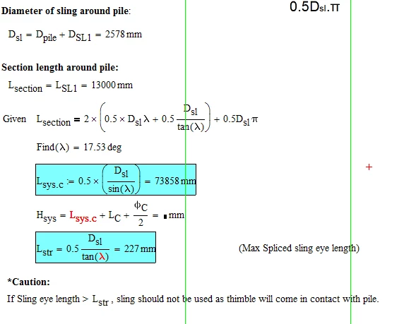

hey lads, attached is my picture again. I cant post the sheet due to certain calculations. And my main problem is that I am using global assignment for definition as I needed to show a summary of checks from the back of the sheet at the front page.
My main problem is if I could global assign the angle that I used the FIND function to calculate. The blue highlighted area are the parts where I have to manually input the angle. I want to global assign so that the next user does not need to manually insert the angle.

It is possible, but then more items need to be defined globally. Here it is:
Now, with lambda globally defined, you can use it anywhere on the sheet.
