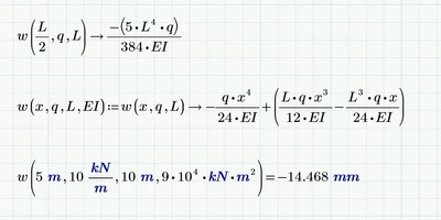

I'm just trying to write a simple integral equation for the beam deflection (simply supported beam with uniformly distributed load).
Could anyone correct me where is the error that in the end it does not come out as it should, i.e. (5/384)*(L^4*q) / EI ??

You are a victim of Primes infamous autolabel feature.
This is especially a PITA in combination with symbolic evaluation and always good for trouble.
The "L" in your sheet have applied different labels. Some are labeled "variable", some "-" (which means automatic and works pretty well if you just use numerical evaluations) and the worst thing is that some are labeled "unit" (Liter). You have to manually label all those "L"'s the same to make it work.
Furthermore the numeric eval of w(...) failed because the value for "EI" is unknown.
You may either provide this value at the very top of the sheet or you turn w into a function with EI as its fourths argument:

Are the same actions possible for a simply supported beam but with partially distributed load ?? This seems more complicated than that. To avoid confusion with the unit (as you wrote above) I, I changed the length marking "L" to "LHB"
