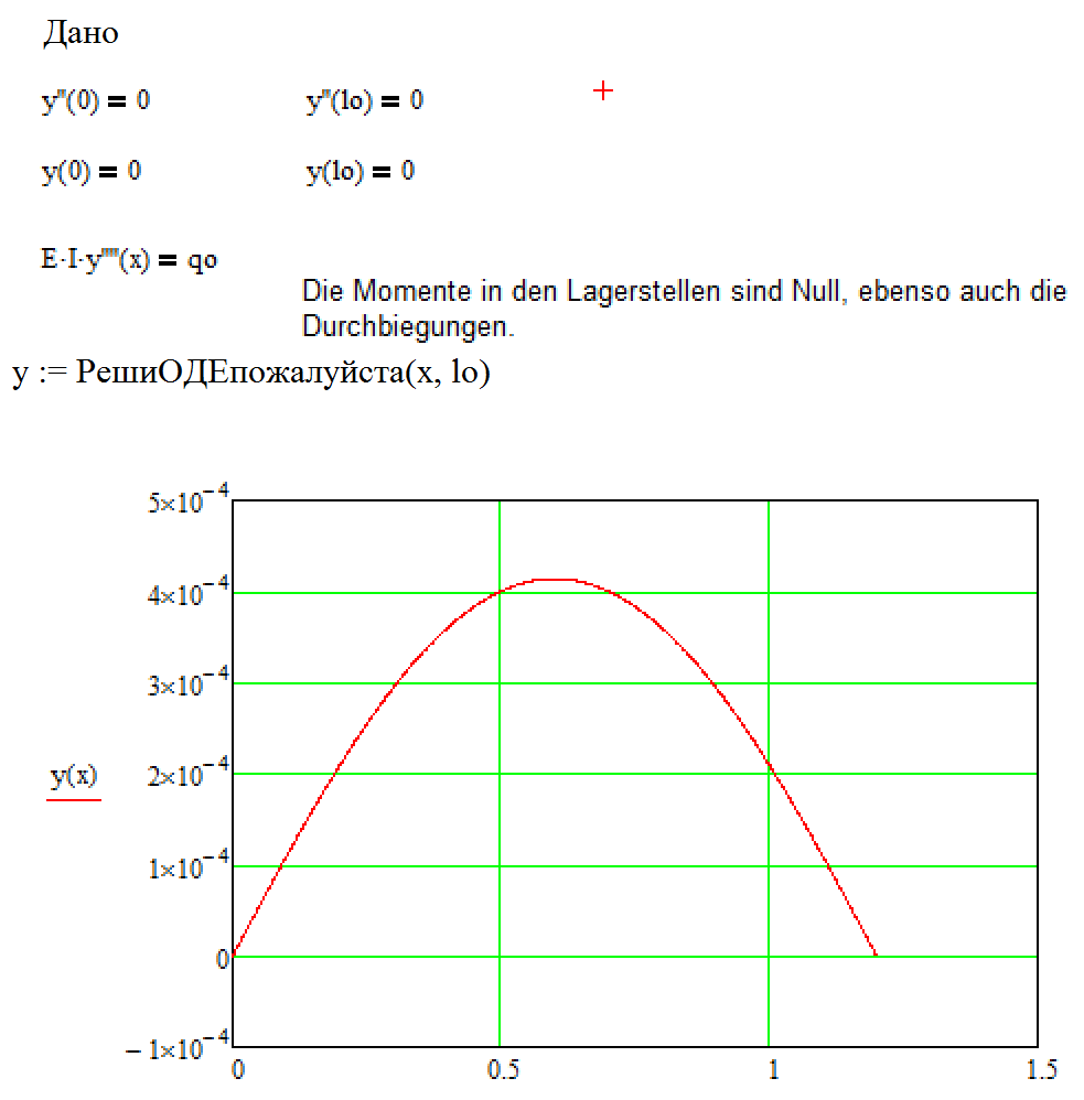

I'm trying to solve the deflection of a beam with a constant load along it's length.
I have a differential equation of 4th degree with four initial conditions.
The moments in the bearings are zero and the deflections as well.
Now my question is: Why don't i get a solution with "Gdglösen" in MC15 although i initialized four conditions?
Error Message: "to few conditions"
Any help appreciated!
Best regards, Volker

Impressive!
but when asking for y(lo/2) (at the end of the sheet) i get again an error message.
Now the same problem in MP4:
And why do i get no solution here?

Delete please operators on the right part of the sheet
