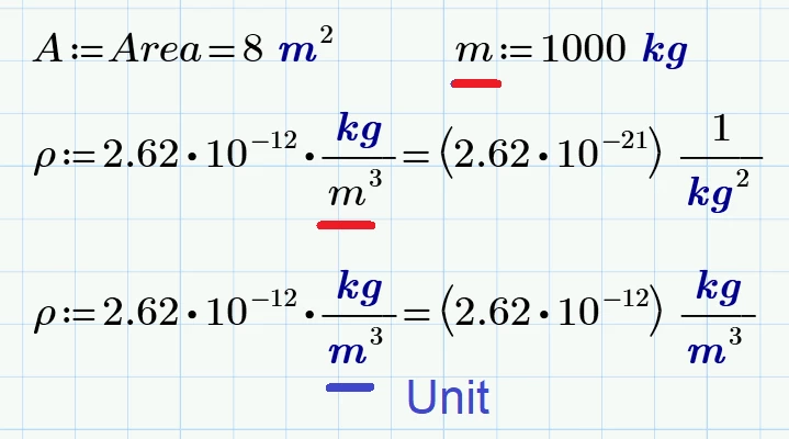

I have an issue with the dimensions of density, variable roe, changing after I define it.
I defined roe := 2.62x10^-12xkg/m^3.
When I used in a calculation I did not get the result I was expecting, especially with the wrong units.
So, I displayed the value of roe right below my definition and the units changed;
I got: roe = (2.62x10^-21)x1/kg^2
Where did this come from?
I ended up defining roe in terms of slugs/ft^3 and the equations were correct then on.
I entered: roe := (5.084x10^-15)xslug/ft^3
When I then displayed the value of roe in English units I got: roe = (2.62x10^-12)xkg/m^3
just like it should be.  The following equations are solved correctly.
Question: what gives?  I attached the actual Mathcad file.

m - mass and meter - black and blue. Blacks and Whites, pardon, Blues live matter!
August 10, 2020
daleshell1-VisitorAuthor
August 10, 2020
Thanks, I can't believe I missed that.

What happened? Did you use the operator m:=1 kg again? Nothing wrong! You will leave our mental hospital in two months completely healthy!
