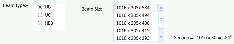

I have two list boxes (MathCAD Prime 11.0.0.0), The selection of one list box drives the list of the other box (see picture). The problem I have is the values update on re-opening the sheet. I can get the sheet to remember the 'Type' selection. However I can't get the second list box to remember the selection from the previous save and close. Below is the code in the jscript:-

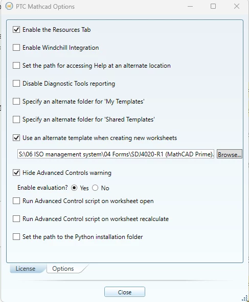

The sheet options are shown in the screen grab 'sheet options selections.png', I have seen that if items in this list to do with scripts could be a solution, but the check options don't look they would help as they are to run scripts.

With your Mathcad options of not running the Advanced Control script on worksheet open or recalculate, you can have, say, HEB selected on the first List Box and HEB320 retained on the second listbox upon saving, closing, and reopening the worksheet if you... upgrade to PTC Mathcad Prime 11.0.1.0.
This is one of the things that was fixed from 11.0.0.0 to 11.0.1.0. https://www.ptc.com/en/support/article/CS449753

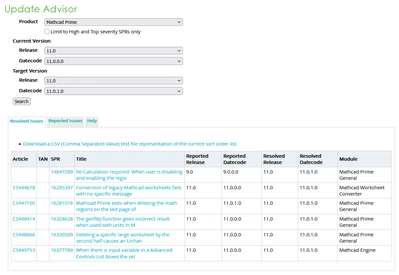

You're familiar from Prime 10.0.1.0 about the PTC Update Advisor:
Unfortunately, the Update Advisor remains an incomplete list. It only reports resolved issues that have an SPR number. There were other things fixed as well but aren't documented here or anywhere else. In fact, even I don't know what they are... Sure makes it hard to market it, huh...
