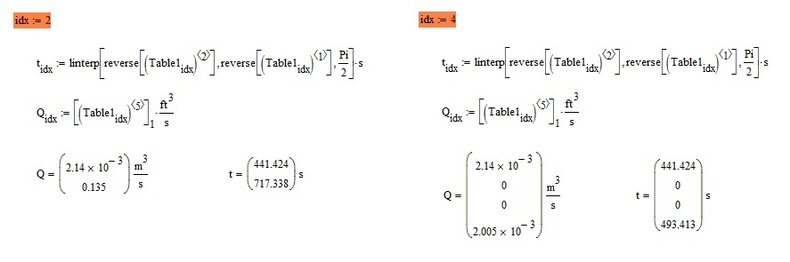

Thanks Andy, but there is a way to "idx" may also be used to generate vectors "t" and "Q"?
when I try, I get this

Hope the attached sheet helps.

It is perfect. Thank you very much to all.
