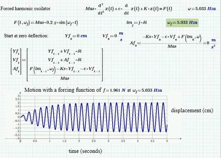

If this is true, you might think about letting Prime fall back to Express.  (That's what happens when a "30 day evaluation copy" times out--the "premium features" are disabled.)  Since I've retired I can't justify the retirement special of $300/year for a license; so I'm constrained to Express.  It feels a lot like very early Mathcad: no programming, no solve blocks, and some strange selections in regular features.  (I'd stay with 3, or get 4.0 if you can--later versions splash a large disclaimer across each page, 4 has it  as a footnote.  There is a fairly strong effort on this forum to expand Express through innovative math; you can even put gridlines on the native graphs!  Built in 4.0 Express:
