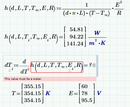

I'm trying to derive a formula which is a function of six values. Four of them are just constants but the other two are vectors of three values.
d = constant
L = constant
T = [T1, T2, T3]
T_inf = constant
E = [E1, E2, E3]
R = constant
I want to get three values from the dT_i. Thanks..

You can't take the derivative w.r.t a subscripted variable, or a variable that is a vector. The easiest solution is to first create a function, and then apply that to the vector variable.

It's hard to debug a picture. Try using the vectorize operator over the derivative of the function. If that doesn't work, please post the worksheet.

Thanks for your reply. I couldn't figure this out so here is the file.
I hope someone can help.
