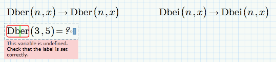

They are not predefined. If they existed, I should think they would be called Dber and Dbei, similar to the derivatives of the Airy functions DAi and DBi.

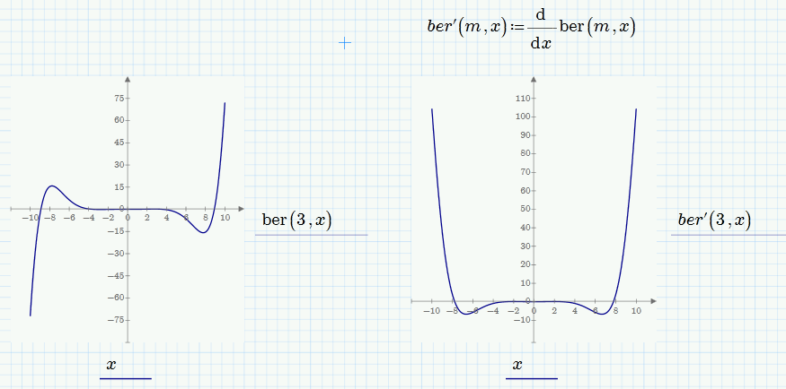

But that should not impede you to use them:
Or, in Prime:

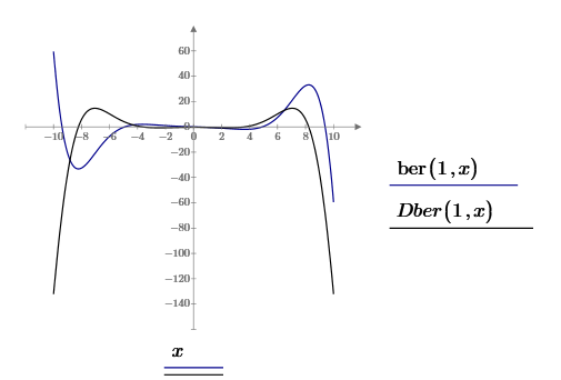

Prime knows even how to express them symbolically:
gives:
because:

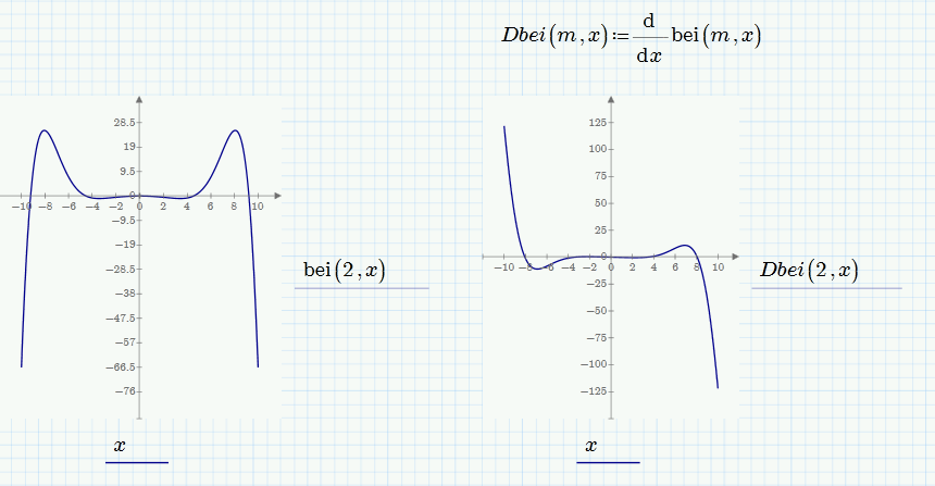

Prime does not provide those derivatives of those Bessel functions out of the box, but you can define them yourself:
You may even use the prime symbol ' in the name by first writing the name as text between quotes "...." and then deleting the quotation marks.
