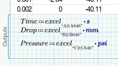

Just a question because I am confused: When I look at the Excel component
I can't see that you export column A to a variable "Time", Nonetheless variable "Time" with the correct unit seconds is defined after the Excel component. I wonder where an assignment like
which obviously must be present would hide ?? I was not able to find it even after resizing the component.

Time is in the output of the spreadsheet.  Not sure why you don't see it.

Crazy, I knew that that definition for Time in the Output area must be somewhere, but I am still not able to make it visible.
