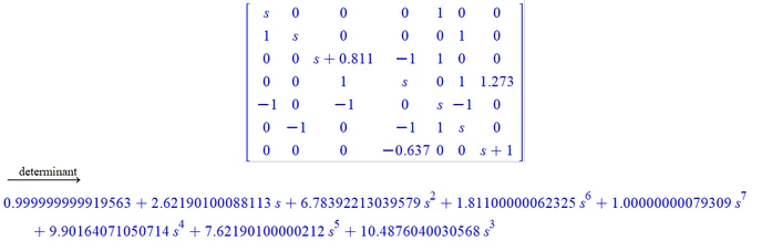

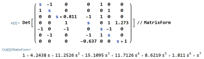

Mathematica result:
Maple result:

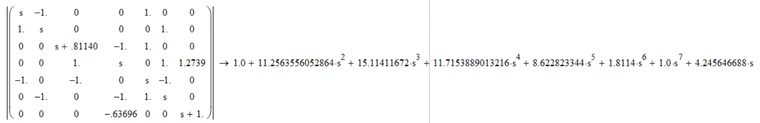

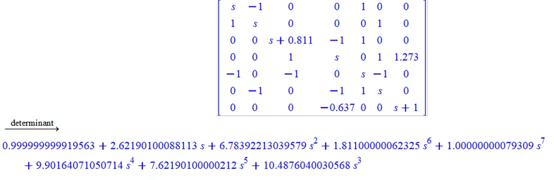

Mathcad 11 result:
Mathcad 15 result:

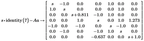

Mathcad Prime 8 result:

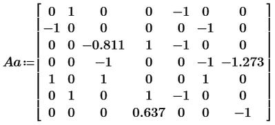

Why does Mathcad Prime give such a result when calculating the determinant of that matrix? Is this some bug from prime? or?
Mathcad Prime 8 file attached.

In Maple you have a typo - first row, second column

Did not influence pretty much...
Anyway, strange how Mathcad Prime calculates this determinant...

still quite a large difference compared to the other solution! Look at the coefficients of s and s^2. All other programs get 4.2 and 11.3 but the result of Maple significantly differs!
In P8 you may try modifiers like "collect,s", "expand" or even just "simplify".
