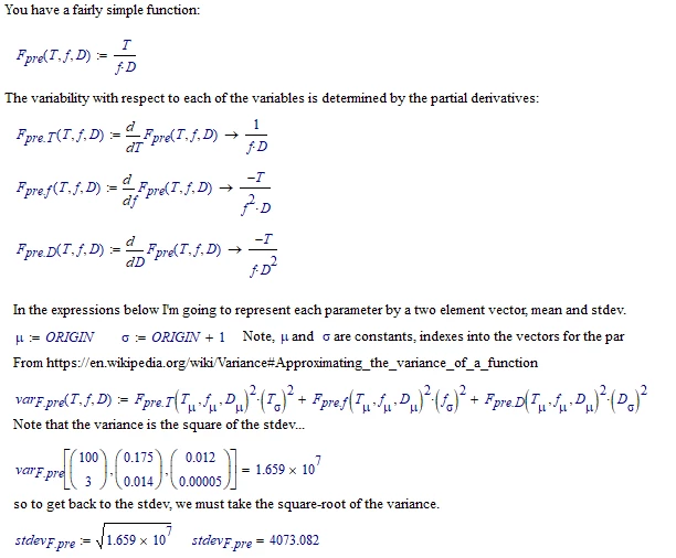

A little experimenting:
That's pretty close to the result of your MonteCarlo run's stdev (4300 N)...But no proof!

You might want to look here
https://en.wikipedia.org/wiki/Variance#Product_of_independent_variables
for information on symbolically/analytically determining the variance of your function result from the variances (and expected values) of its input variables.
