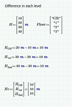

HI,
I just need some help to simplify Hz in a simple mathematical  program.

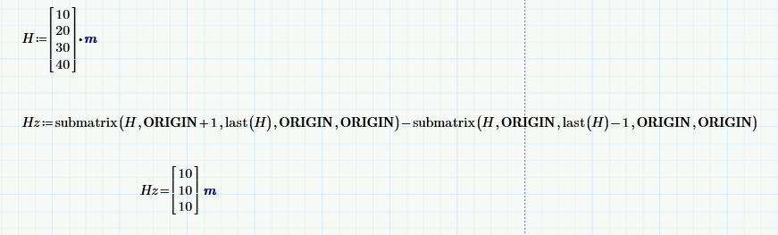

Something like this:
(Attached is Prime4 file)
ldante11-GarnetAuthor
11-Garnet
April 5, 2017
Great .. Thanks

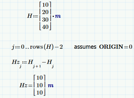

A bit more easily understood:
Luc's is a more general application, above is less typing!

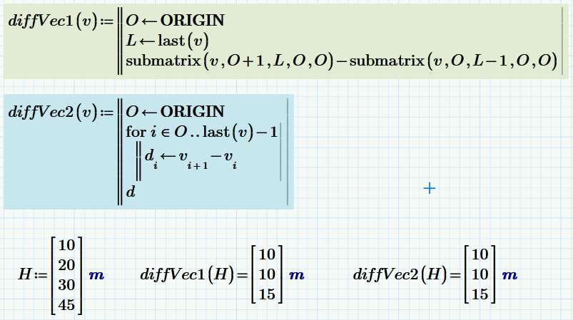

I would vote for using functions to do the jobs. Especially if you need to calculate a difference vector more than once.
Here are two examples - basically reflecting the two different methods shown by Luc an Fred.

I will save this all as my reference . Thank you ..
