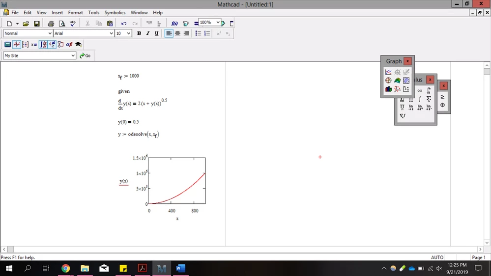

different between y and y1
Do i have to use y1 when i sove ode or not?

When you solve via solve block it does not matter which variable you assign the result to.
You may use
a:=odesolve...
y:=odesolve...
or
y.1:=odesolve...
It does not matter.
