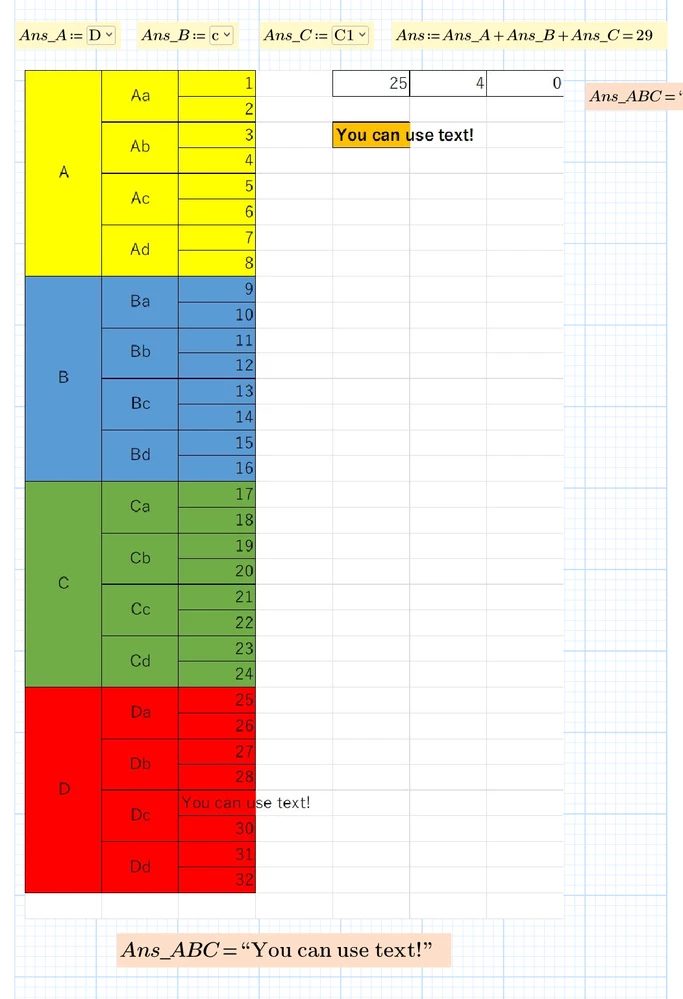

ttokoro
Oct 13, 2022 6:31 AM UTC
Combo box with EXCEL can select what you want from EXCEL sheet data in Mathcad. Prime 8 sheet attached.
t.t.
LucMeekes23-Emerald VAnswer
23-Emerald V
Oct 13, 2022 9:09 AM UTC
Ttokoro's file translated to Prime 7.
