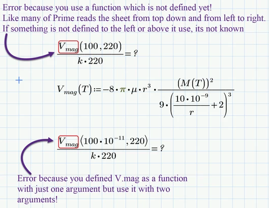

Is this what you want

You should:
- Clean up your worksheet and state clearly (by showing side-by-side) what the difference is you see.
- State  what version of Prime you are using.
- Know that Boltzmann constant and vacuum permeability are in the list of known constants in Prime (Check the constants in the section of Operators and symbols on the ribbon) :
