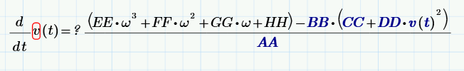

I’m trying to solve partial differential equation, shown below:
After some simplification, the equation will be this:
I can write Tm as a 3rd order polynomial trend line.
finally after some reorganization the final equation:
I'd like to plot V(t) vs. t
Am I on the right path? Last time I solved differential equations was 20 years ago, and I was not good at it I still have some weak memories of differential equation solving when both the function and the first derivative are in the same equation. I tried to solve this in excel with numerical differentiation but that one did not yielded good results either.
Any help if greatly appreciated. thank you!

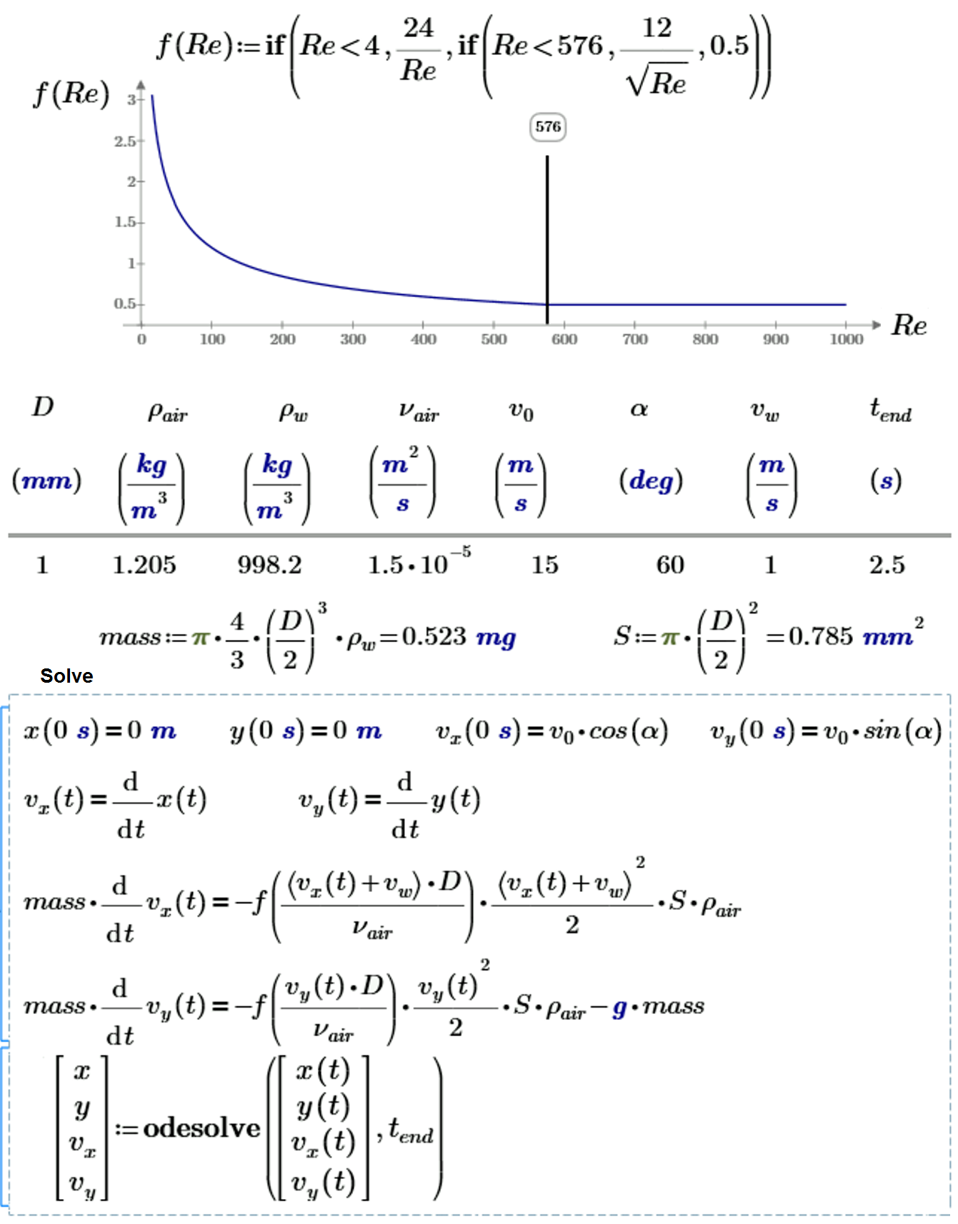

If your ODE is y'(t)=a+b*y(t)^2 you can solve it symbolically..

Valery, you're right. I believe too, it's a ODE in the form you've mentioned. I'm still not sure why mathcad does not like the notation this way.

One example

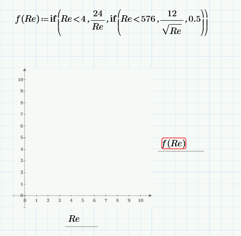

Valery, I tried the ctrl+= but it did not work. I also tried the example you've shown and it won't even plot the graph.
August 31, 2015
Re ist the name of a built-in function, therefore the error.
Either define an appropriate range variable Re or use a different variable name - just in the plot, you can leave Re in the function definition.
